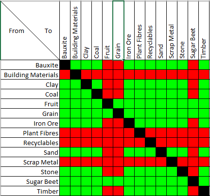

FIRS bidirectional transportation 9 years 8 months ago #5873
The table below shows all possible refits at stations for bulk wagon. Green means refit is possible. Red means refit is impossible.
Though refits marked with red can be done in depots, this leads to potential jams, when added to vehicle orders.
