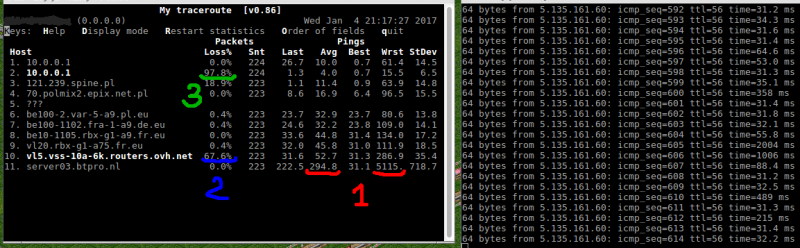

From time to time I'm playing on FIRS server #9. Usually I'm experiencing connection problems. The game lags, sometimes just lightly but sometimes really intensively. Sometimes I'm loosing connection and have to reconnect.
As I figured out, the lag is strictly correlated with high ping. When ping goes high, lag appears. Higher ping - higher lag. I'm using ping from iputils with default switches:
Code:
ping 5.135.161.60
I also tried mtr:
Code:
mtr 5.135.161.60
Here are example results:
I'm not an expert so I'm not sure how to read the results. Anyway, high ping values (1) appears on your server.
There is also ~66% packet loss (2) at OVH, but since the loss at btpro server is 0% then there is nothing to worry about? I'm not sure how to interpret this.
There is almost 100% packet loss (3) at 10.0.0.1, but this a false positive probably. Whenever I'm mtr'ing anything I'm getting similar results - 10.0.0.1 is duplicated and packet loss% at these two nodes sums up to almost 100%.
My computer is connected to a home router (NAT) but the router doesn't appear on the mtr list. The router is connected to another NAT server 10.0.0.1 which belongs to my ISP.
I never experienced similar problems on non-btpro servers.
